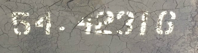

What is this number in my Canadian M37 hardtop?
Posted: Tue Nov 14, 2017 10:37 pm
by 808morgan
number m37.jpg (110.28 KiB) Viewed 3281 times

First, welcome to the community. Tell us more about your truck and yourself. Now, as for the painted number, I have no sure answer for you, but perhaps it is some "inventory" control identification. A hard top is a pretty important part of a truck, and I suspect whatever military unit had it originally wanted to keep tabs on it. Sort of a serial number thing maybe.
But i suspect someone more knowledgeable than I will be along shortly. And again, welcome.

That number is the CAR (Canadian Army Registration) number which will be stamped on the left front frame horn if its original for the truck. The CAR later became the CFR (Canadian Forces Registration) number. At one point the CAR/CFR would have been stencilled on the doors. Canada did not use hood numbers in the fashion of the US military. If its a Canadian truck, you will find the serial number stamped on the frame, drivers side just behind the rear cab mount. This is different than the US production. The serial number should match the Data Plate number if its original. Hope this helps answer your question.

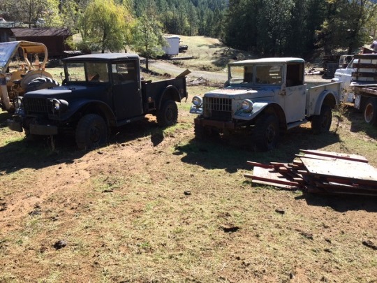

Well this truck is going to be my friends, I'm getting a different one actually. I didn't know that when I asked the question. There are two M37s on my friends land, one is the Canadian. I wish I could restore the M37F but it's too much of a project for me, but it isn't in bad shape if anyone is interested. I'm in N. CA. These trucks are in Potter Valley, CA.

Jess wrote:That number is the CAR (Canadian Army Registration) number which will be stamped on the left front frame horn if its original for the truck. The CAR later became the CFR (Canadian Forces Registration) number. At one point the CAR/CFR would have been stencilled on the doors. Canada did not use hood numbers in the fashion of the US military. If its a Canadian truck, you will find the serial number stamped on the frame, drivers side just behind the rear cab mount. This is different than the US production. The serial number should match the Data Plate number if its original. Hope this helps answer your question.
I've heard the US records are all gone, did the Canadians keep any, is there any way to find out where it has been?

Unfortunately, the records were destroyed sometime after the units left the service. Many CFR numbers have been reassigned, so anything in the system now would be for something else. Same with most of the early deuces and other stuff of that era. I don't think Build cards are available for the Canadian WIndsor, Ontario built trucks. Too bad, as it would have been interesting to see the trucks history. One of mine was purchased directly from the government at a disposal sale in the city where I lived at the time. The battalion that used the truck was still in the garrison, so I know that it served with 3PPCLI (3rd Battalion, Princess Patricia's Light Infantry) but nothing more.
Any of these old 60+ year old trucks will need work, but that is what makes them interesting and fun to have. Parts are still available and reasonably cheap, compared to some hobbies. Enjoy yours and we'll follow along from out here.
