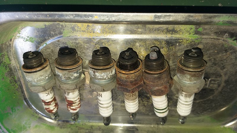

Sorry if I missed it earlier in the thread, but have you pulled the plugs to check their condition? If you are running significantly rich, shouldn't the end of the plugs be blackened?

I just ride with the bigger plate just a little bit and I put the small one back,
here is a picture from them. 1 to 6 from left to right:

Your center electrodes should all look the same. Do you have an intake manifold air leak hence uneven air/fuel mixture? Hal

The electrode on #5 looks much longer than the rest of the plugs.

Yeah, one of these things is not like the other!

Dicktater wrote:The electrode on #5 looks much longer than the rest of the plugs.
It also looks like the only one that is not all carboned up
