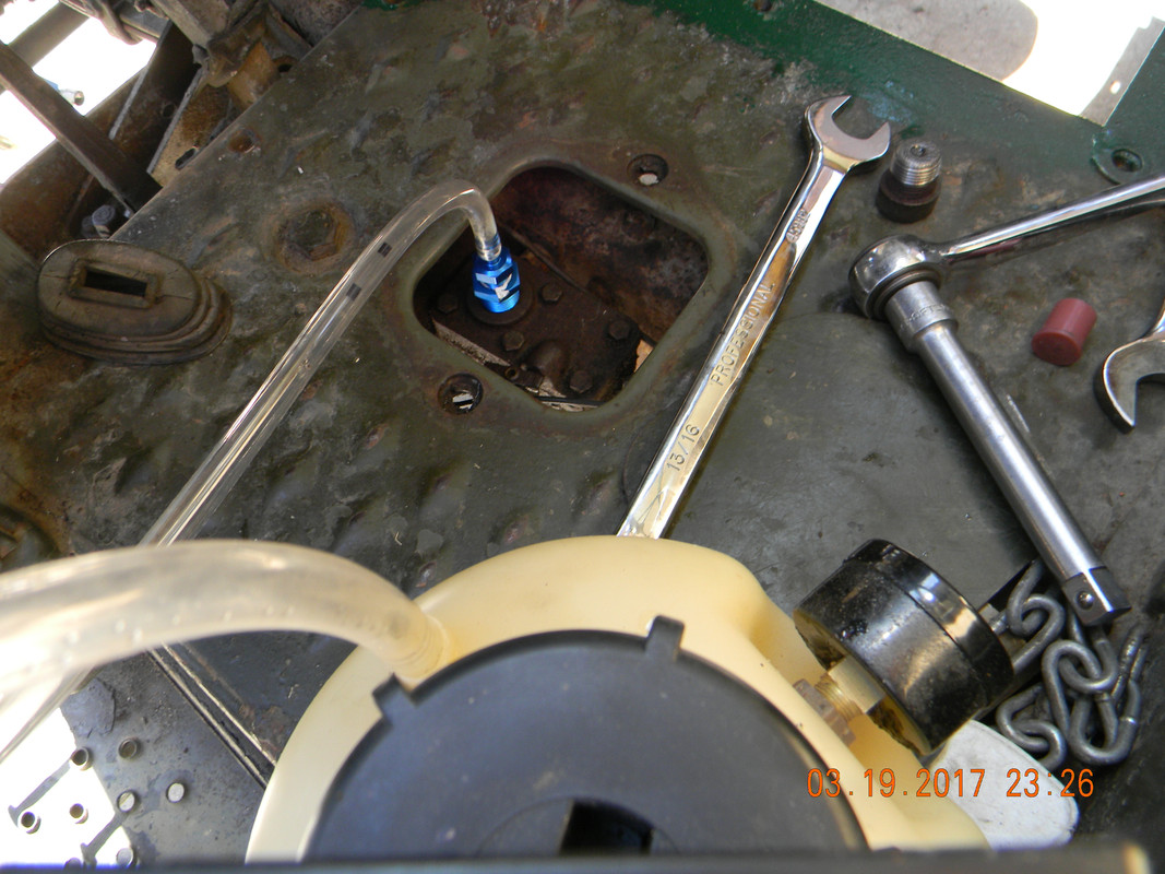

I made this up to easily pressurize my MC, and bleed my brakes by myself. Be sure to turn off the vent valve, or you will pump brake fluid out onto the garage floor. Bought from Jegs or Summit a half inch NPT fitting and then from same a smaller NPT with a nipple, and a Motive pressure bleeder which I have used before on other cars. Let me try to post a pic.... Hal.
Image[/img]

ok try again.

Is it hand pumped Hal?

by NAM VET
yeah, a tank with with a pump handle, with a pressure gage, and a plastic hose you can connect to whatever fitting you want. Takes a little planning to get what you need, but works slick as a whistle. Jegs or Summit has what you need. Hal

by Cal_Gary
Same as Hal-Motive bleeder with a fabbed MC plug.
